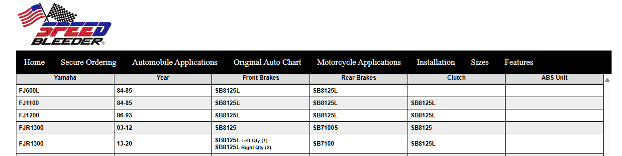

Anyone have the correct speed bleeders part numbers for the FJR?

https://www.fjrforum.com/threads/what-d ... st-1227952
This looks to match my order history. IIRC, the smaller one I didn't order because it was the same size as the ones for my DRZ, or another bike that I had one random one hanging on the pegboard.SpeedBleeder Part Numbers for my FJR:
front - SB8125L M8 x 1.25
rear - SB7100 M7 x 1.0

I'm not 100% sure about the chart that I posted from the Speed Bleeder site. For '03-'12 they only list two bleeders for the front but three for the '13-'20. All FJRs from 2006-up should have three for the front. Also, they list the SB8125L for the later years but SB8125 for '03-'12.
I didn't notice the discrepancy when I looked it up but I would want to check.

From that same thread I linked to above, the last character in the part number, the L specifies if it's the longer version. Looks like there's an LL and an S as well.

SB8125 - only question if it is the "L". Not sure if it matters.Intech wrote: βFri Jul 18, 2025 11:33 am Thanks. I have 4 of the SB7100 bleeders, so I now have one speed bleeder on the bike. I rode it home from ND with pretty much no rear brake. Just got done bleeding it and the rear is good now. I need to order the other bleeders. They are the cats ass! The clutch is the same as the other three front ones?

Bob, do NOT get the L model for the clutch! Too long. Get the S model. The L is fine everywhere else including the rear one. And yes, the 3 fronts and the clutch are the same threads.

The S (short) has a short nipple, and I find it takes a silicone hose to stay on... the regular SB8125 or the L work..... yes a regular one on the clutch slave will make things easier..... but so will a 2.5 or 3mm ID silicone hose. If you're ordering from Speedbleeder, I'd recommend their silicone hose.... it's not that easy to find elsewhere.
ONly the rear is a 7mm SB7100.
