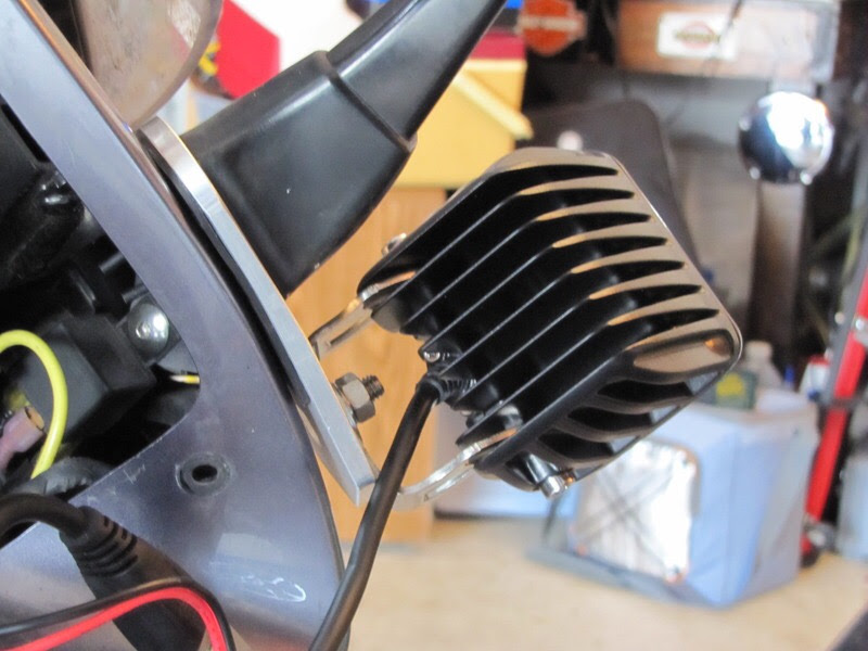

Allow me to assist. I've had WynPro brackets for aboot 5 years. Here are a couple of pitchers from when I installed 'em.
From behind.
From the front.
Let me know if you would like any additional pictures or information aboot 'em. They keep my Rigid lights rock-solid steady. I briefly had the Rigids on a set of Garauld's brackets, but those just weren't strong enough brackets for the heavier Rigids - they vibrated like crazy. I had Hella FF50's on there for a number of years with no issues using Garauld's brackets.
Jalingo loved this

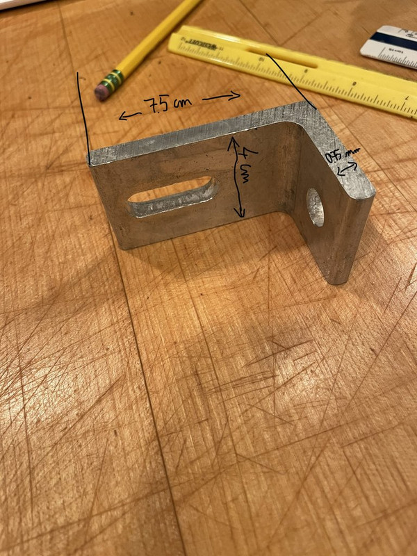

Can you please give me all the measurement of the Wynpro ? If possible ,they low profile !!! Is very nice
I found this bracket that I’m going to customize , I really don’t care about the look as long as it’s functional and keep the Denali D7 rock steady , they are very heavy
Or might make a copycat of the Wynpro
What do you think about the length ? Is it enough ?
The thickness on the length can be reduced a little , what do you think ?
I have not yet removed the mirrors to calculate
