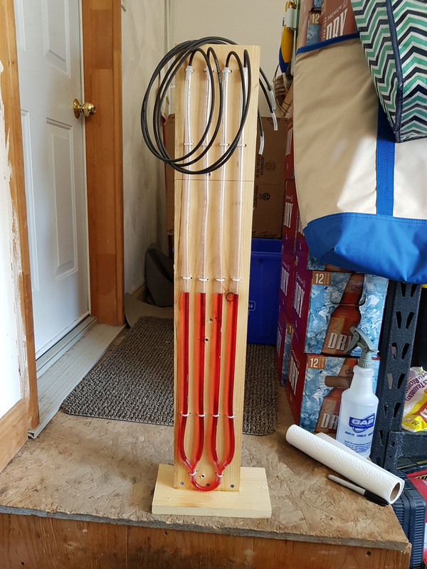

TBS is a piece of cake as long as you have a suitable manometer/gauge. If you don't have one, it is easy to make one using Tygon tubing and a couple of "Y" connectors. Fluid is ATF and short lengths of some finer tubing inserted into the 1/8" black takeoff hoses to reduce jumpiness. Can't remember what sizes I used... Very sensitive but fluid could get sucked into the engine if synchronization is off by a lot. Just have to be careful - I start with all lines crimped with binder clips and carefully open them one at a time. (A couple drops of ATF wouldn't hurt anything) A lot of people use the Morgan Carbtune Pro - doesn't use fluid.

Hahahahahaha! I'm still waiting for my blood pressure to return to normal. There were some tense moments here and there!

FJRoss: I have the Carbtune tool but thanks for the information! After working on this over the course of 7 days, I'll just schedule another Saturday over the coming weeks to balance the throttle bodies. It's idling smooth as butter right now anyway.
