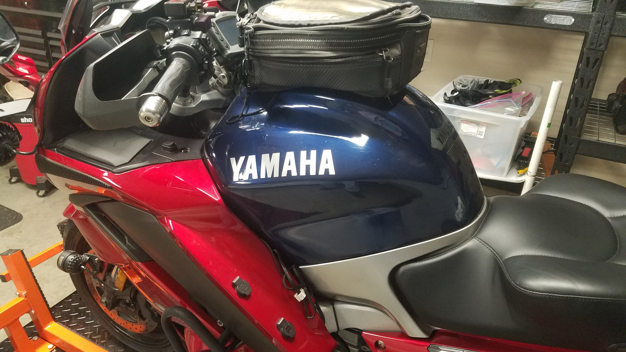

Ask Griff about his Frankentank.

Man that tank is a work of art.

Re: Stupid Aux Fuel Question
It’s the pinnacle. Mind retelling how it came to be?
This is the first tank that Dirtracker(?) Harry Slaughter of Iowa built for his FJR a few years ago. It is a 9 gallon tank, complete with the fuel pump, so it is basically plug and play to switch tanks. I bought it at the end of 2017. I saw several of the larger versions on FJRs at the IBR this year. My 9 gallon size poses no problems with the handlebars or tank bag interference. I considered painting it red, but I think the blue kinda complements the red

There are fuel cells that go in place of the back seat but don't mess with the top case. If you carry a passenger then the Tail dragger is the one. The Frankentank is a great way to go but probably not cheap
