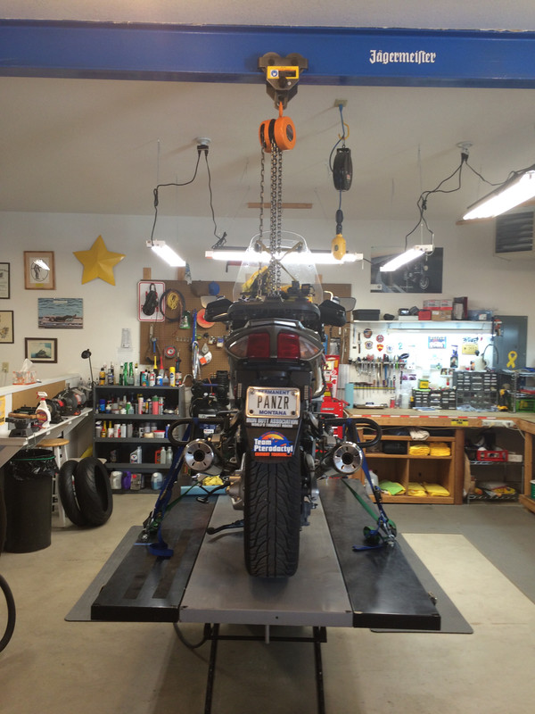

- Pterodactyl
- Posts: 2525
- Joined: Wed Feb 25, 2015 2:16 pm
- FJRModel: R1250GSA w/ Sidecar
- Location: Big Sky Country
- x 711
- x 6891
Re: 16k maintenance question
0face, escapefjrtist, CollingsBob and 2 others loved this
- Posts: 1233
- x 471
- x 1300
I also use rafters. When working on the center stand, suspension or swing arm a few 500lb ratchet straps at the rear and a Canyon Dancer at the handle bars to keep it from falling over. I lock the bars, bike won't swivel that way.
Don't over think it......
CollingsBob loved this
- Posts: 10163
- x 3389
- x 12549
Pterodactyl thinks his FJR is a Panzer tank, so has the big beam, powered by Jagermeister. 2x6's will handle the load, and you have to either put the front wheel in a chock with some kind of ties or Canyon Dancer to keep the bike from flopping around. If you had a lift like mine, just clamp the front wheel, it won't go anywhere. If you have the rear wheel on a 2x4, you won't have to lift it very high to free up the centerstand.

I cut up a sheet of 1/2” plywood into strips, then sistered a convenient 2x6 joist - offsetting the joints on every layer until it was 4” thick...using industrial adhesive and a gazillion wood screws. I then drilled a 1/2” hole, put in a eyebolt and bought a cheap chain hoist..
