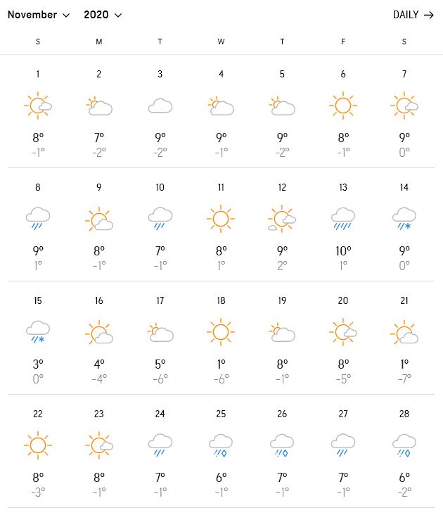

I think we may be OK for a little longer. Temperatures for the remaining bit of October and for much of November are forecast to be mostly above seasonal norms. As long as there isn't salt on the road and temperatures are 5°C or higher, I'm good for a ride with a heated jacket liner. (I can manage lower temperatures but it isn't any fun) I hope I can hold off that final fill with premium gas (no ethanol here for premium) for a few more weeks. Winter works projects for the bike include a valve check, some electrical rewiring, fork bushings and seals, Penske shock to be sent off, LED headlights, relay arm service and maybe swingarm.
