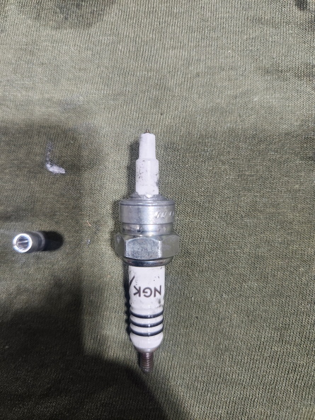

I carved out some time to continue the pre-season routine. Today's tasks included flushing fork cartridges and reassembly, changing out spark plugs and maybe a coolant flush and fill. I pulled the tank and removed the spark plug wires, blew off the top of the valve cover to keep the garbage out of the cylindars. Pulled the plugs with no problem. Prepped the new ones with anti sieze and removed the end caps. #4 & #3 went in smooth as butter. #2 when in, then something felt "off". A subtle pop, or slip - like the ratchet skipped a tooth. I slowly backed out the spark plug. I cleaned the anti seize off it, and it looked fine - no visible indication of something being off. I thought that maybe there was something in the threads of the cylinder - so I hit it with the shop vac to make sure; visually, it looked clear. I took a new spark plug and ran it into #2 - butter smooth. I took that last spark plug and threaded it into #1. It snugged and as I put a bit of torque to it with my stubby ratchet, it popped and the ratchet spun freely. Rut-Roh...
I lifted the socket out and found the broken spark plug.
This was a brand new NGK CR8E-IX. It's not like I was using a 20v Dewalt Impact driver or 1/2" breaker bar to install them. I took a walk to the corner store, grabbed a snicker's bar (you're more angry when you're hungry...) and a can of coke.
Comfort food ingested, FML texts sent - now let's get serious...
I took one of the old spark plugs and cut it at the base of the threads. That let me test fit extractor bits on the bench to confirm exactly which size to use. The straight flute 1/4" extractor seemed to fit best; A 1/4" drive extension end if on it perfectly, allowing me to rotate it with a 1/4" wrench. I gave it 2 firm taps and put the wrench on it. I use anti sieze on the threads every time, and that broken peice backed out smoothly.
Holy crap - That could have been so much worse! But why the hell did a brand new spark plug break so easily? You can see the stubby ratchet I was using - I've always done spark plugs this way; snug them with that stubby, then tighten with my regular 3/8" ratchet.
bungie4, Toter, Hppants and 3 others loved this
Forkin' hell, what the fork was that!! Jeez.... match up the pieces, see if there was a pre-existing crack there before you even started. I can't imagine anything but broken during the threading process..... might wanna bring that to the attention of NGK...... ????
Damned straight use anti-seize. Torque only 1/4 turn or so after gasket seats (by hand). Yammy says 13 ft. lbs., which I tested seems about right after 1/4 turn..... certainly not your fault!!! Glad the crisis was avoided.

Where did you buy the NGK spark plug? Widespread reports of counterfeit NGK spark plugs being sold on eBay and Amazon.

This set was ordered from Amazon; same as the set from 2023, and 2018 before that. Picture below is 2 of the old ones and the 4 new ones (right before I removed the caps).

The next question, "Was it 'Sold by Amazon', 'Fulfilled by Amazon', or a 3rd party via Amazon?"extrememarine wrote: ↑Sun Mar 02, 2025 9:49 pm This set was ordered from Amazon; same as the set from 2023, and 2018 before that. Picture below is 2 of the old ones and the 4 new ones (right before I removed the caps).
There are a number of websites with information on how to distinguish genuine from counterfeit spark plugs. This is one:
https://www.ngkntk.com/newsroom/blog/emea/fake-or-not/
