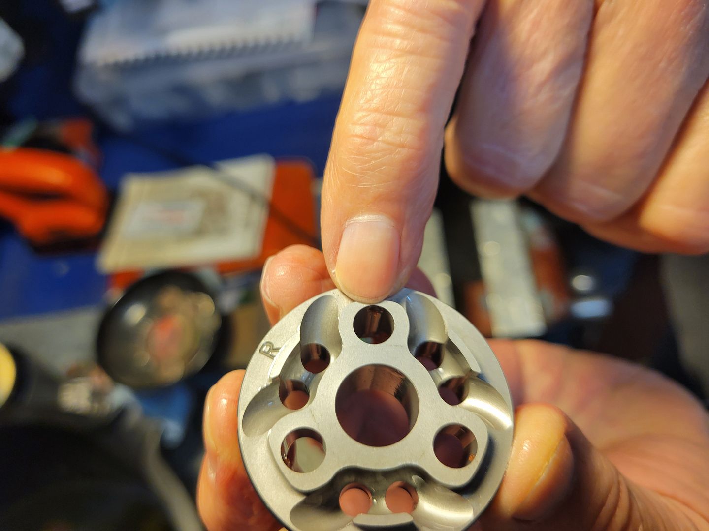

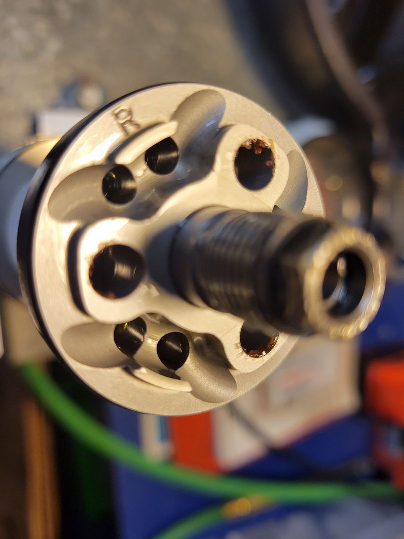

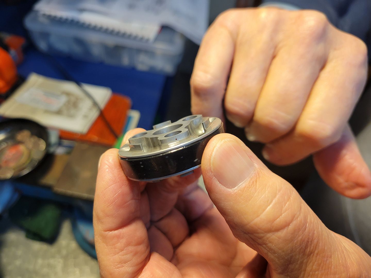

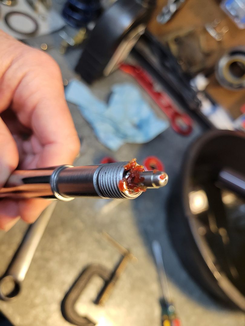

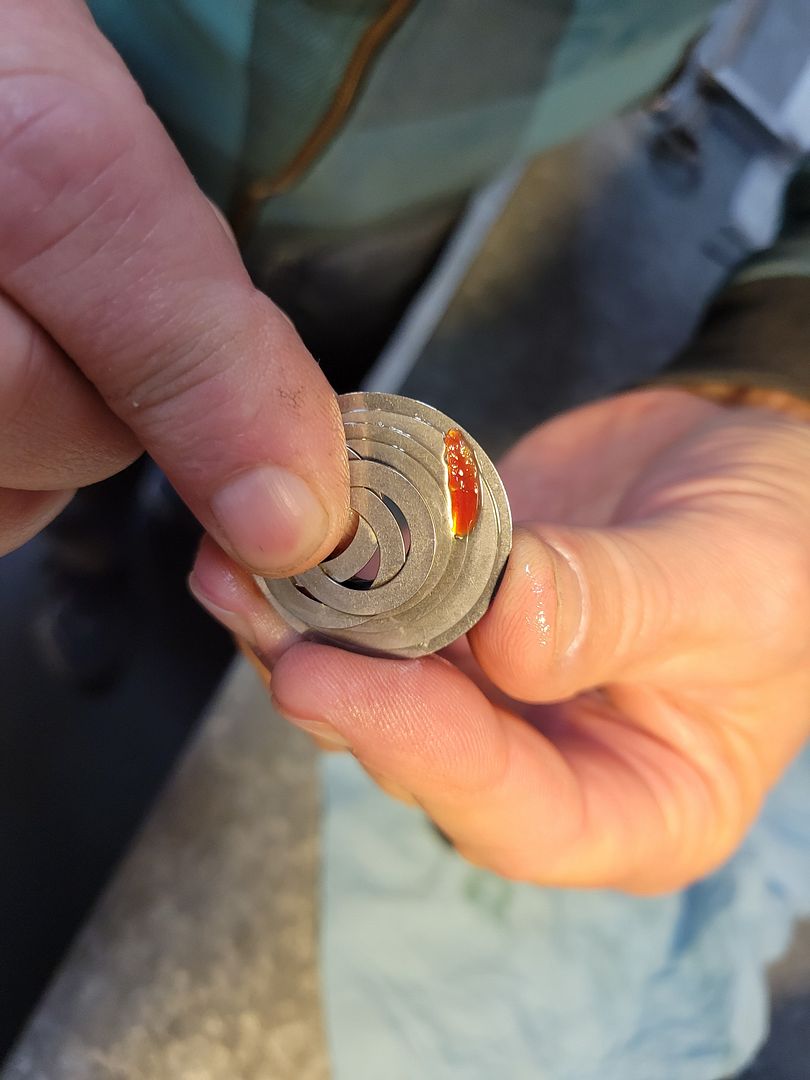

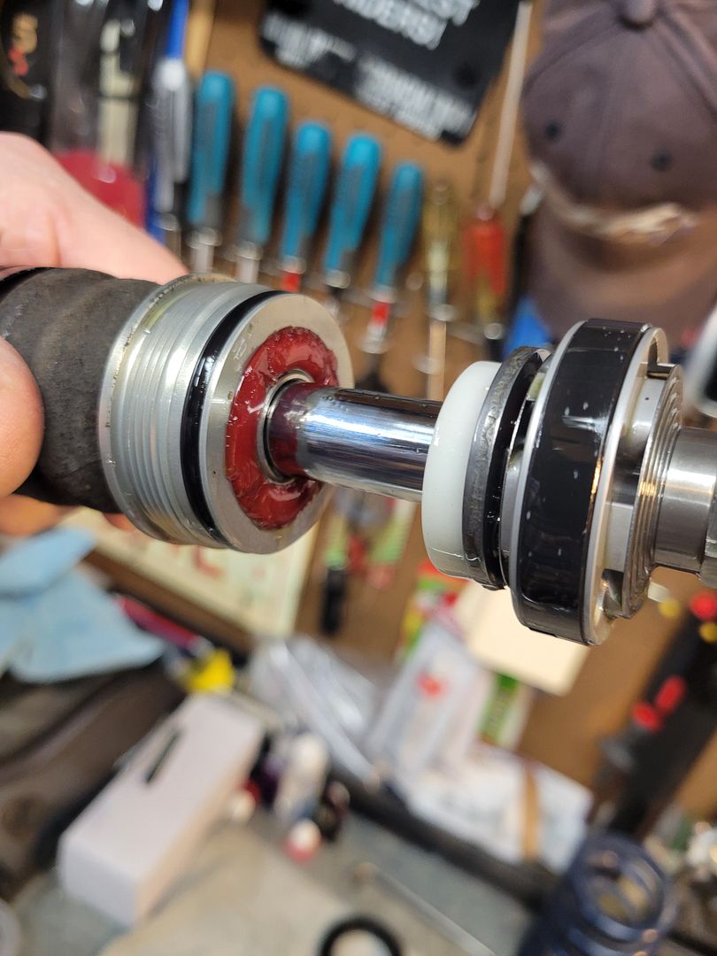

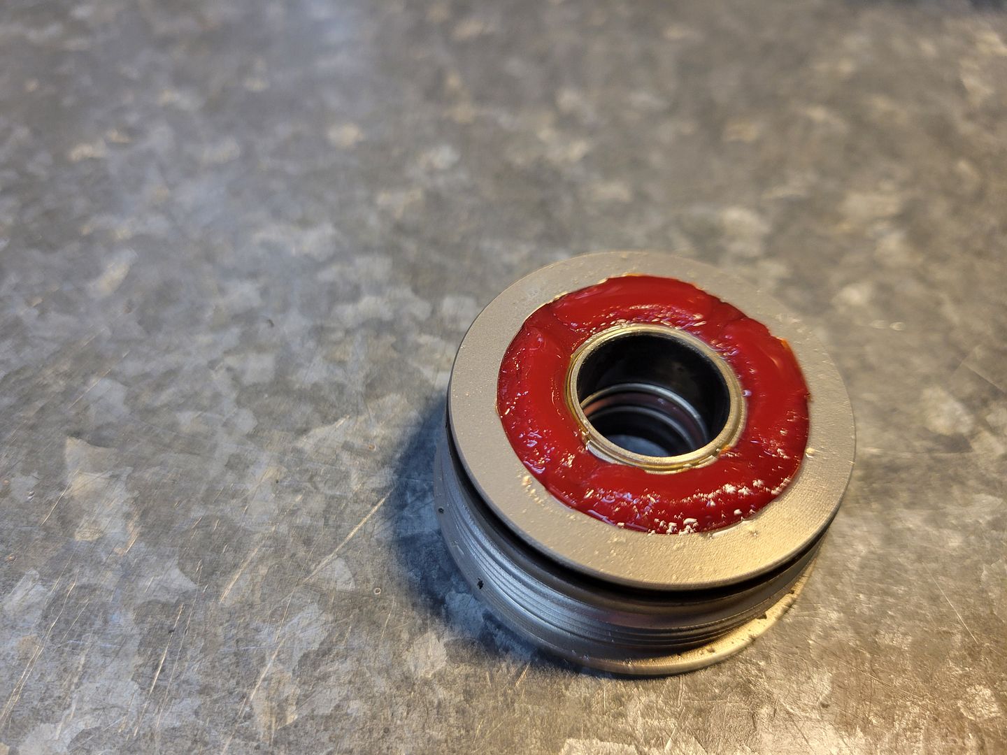

Shock is back on the bike, we found a deteriorating top out plate to be the culprit.
That red plate is some sort of Delrin or something with a little flexibility.
Found pieces of it every where!
Cleaned it well we thought and started put it back together, while stroking it to get the air out of the oil Mr. Shock Pro could tell that it still wasn't right so apart it came again.
This is what the shim stack's sit on and we thought we had cleaned it well but............
See that little hole, there are three and all three were tightly plugged with that red stuff. That's a lot of hydraulic pressure!
If you look you can see the stuff poking out on the inside of the big holes.
Only thing I can imagine is that white spacer has a lot of clearance and could actually cock on the shaft maybe cutting the red deal.
Roads are pretty wet this morning, think I'll go out and do some yard work and see what this afternoon looks like for a test ride.

Yikes! Good thing you got Mr Fart Smeller there! Did you hold his hand while he worked?
