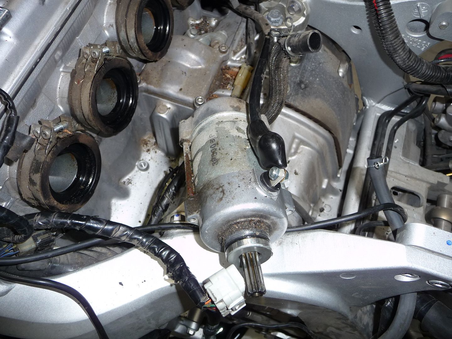

Not only are they clean, but they appear to be mated to the bottom end!
The puzzle put-together continues!!!!

Re: Project Bike - 2006 FJR bike in a basket
I was surprised as well at how clean the intakes were, when I replaced starter on my FJR.
If you keep an FJR long enough, or ride it enough miles, a starter problem that requires at minimum removing it from the engine is inevitable.
My 03 with 75,000 miles would NEVER crank fast. Fortunately, it always started easily when cold. When HOT it would barely crank, so it was very embarrassing and even dangerous to ride in traffic, cause if you stalled it, sometimes you had to pull over to the side and wait a minute for it to cool down a little. Even getting a tank of gas was a thrill sometimes, and when it wouldn't start, it often dropped the battery voltage enough to "reset" the computer and clock. It never left me stranded, I just had to give the old gal a minute to cool off. LOL
I was so intimidated by the procedure required to change the starter, that I sold it and bought an 07 {ABS and the "dark cherry" color being the OTHER reasons I wanted a Gen. 2}
I have met the enemy, and it is me.
- Posts: 10240
- x 3431
- x 12685
At first a PITA as you have to remove the airbox and throttle bodies to get at the starter bolts... never done it, prolly takes an hour to get where you want to go, but not complicated.
