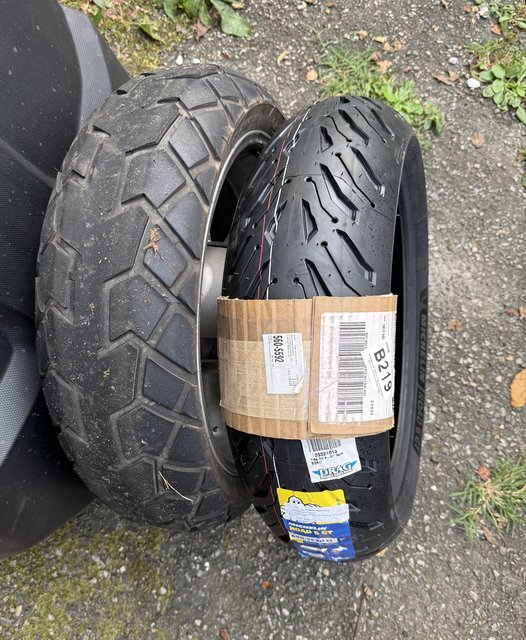

As a part of the post-Alaska trip maintenance, I'm swapping out the rear ADV tire and going back to my tried and true Michelin Road 6 GTs. Front Conti TK70 still has some life in it, so I'll swap that a little later.
Hoping to pull all the tupperware this weekend to clean the calcium chloride out of all the nooks and crannies if the weather cooperates. May also need to do some buffing to bring back her shine, as the clearcoat took a beating up there.

What kind of mileage did you get out of the Conti rear?

It's right at 5k miles as of that picture. Those were hard miles with a lot of crappy/unpaved roads, and even the paved sections were fully loaded with all my camping gear and often running at extra-legal speeds. Overall I was very happy with the performance and the mileage for tooling around the wilder areas of Alaska/Yukon/BC. Would recommend it without hesitation.
For reference, I got 9k miles out of my last Road 6 GT rear, and probably could have done another 500 or so.
