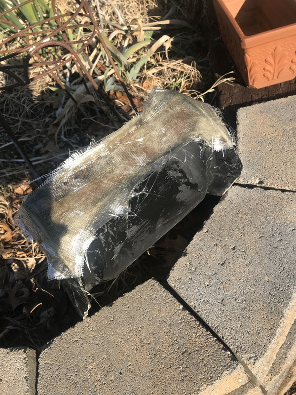

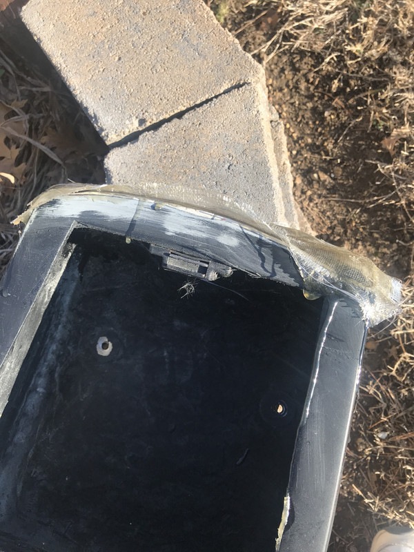

Re: Smuggler in the works
Glass work came out good and strong.
Set it in place on the bike and plenty of clearance and looks even with a correct gap between the the rack and box.
Sanding the rough edges a roughened up the surface for bondo.
