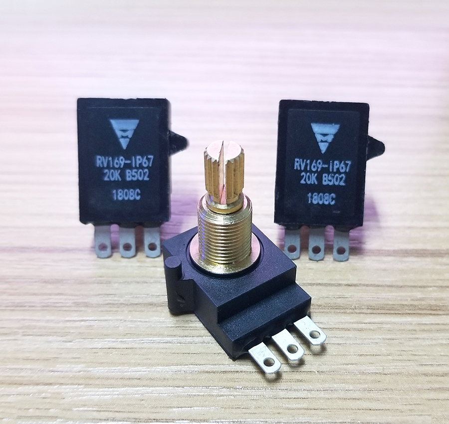

Re: Need a new controller for Aux lights
My controller is fully variable (smooth transition from dim lights to bright lights) and has no cooling fins. The LED lights have cooling fins as part of their housings, and should get plenty of airflow mounted on the FJR forks.
I’m confident the “adjustable” waveform is created by a variable capacitor and a tank circuit; all likely housed in the thimble-sized package with rotating knob. (Where’s that photo?)
Post by ionbeam »
Uncle Hud wrote: Sat Apr 11, 2020 9:44 am ...the “adjustable” waveform is created by a variable capacitor and a tank circuit; all likely housed in the thimble-sized package with rotating knob...
In electronics there are so many different ways to achieve the same end result, and usually there is no 'right way' to get the outcome you need.
The item in the picture above is a 20,000 ohm, waterproof potentiometer, pot for short. IP67 is the waterproof rating of the component.
A common way to solve a PWM circuit is to take a level comparator of some sort, send a sawtooth wave to one pin and a varying DC level (from the pot) to the other pin. Where the DC crosses the sawtooth will determine the output pulse width. In the first picture the DC level only crosses the small tips of the sawtooth and produces a narrow pulse. As the DC goes down it crosses more of the sawtooth creating a wider pulse. The sawtooth never changes frequency or amplitude. For LED lighting the sawtooth will always be more than 60 cycles per second (60Hz).
Uncle Hud and Intech loved this
