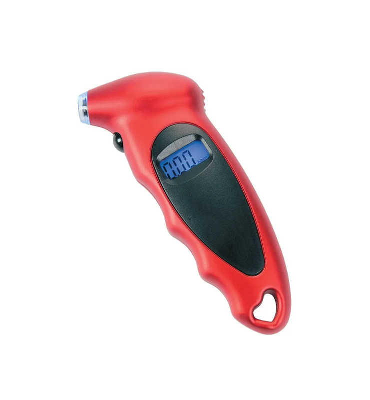

Took FJR out in sunlight, sprayed entire tire with soapy water. Sprayed stem, all along the rim bead, and the entire sidewall and tread. No bubbles. It was at 40 psi when I started. I had set it to 42 psi the day before but I also always lose a bit of air when I test air pressure. So evidently a very slow leak. Looks like this just became my day ride bike if I can't trust it over several days unless I get to the point where my 250 mile leaking tire becomes my burnout bike. I'll keep watching. Anybody recommend a tire gauge that locks on without losing air first?
- Posts: 2901
- x 915
- x 2671
I just use one like this. I lose very little air as long as I get it straight on when applying to the Schrader valve. I have angled valve stems but this will work OK with regular (short) FJR stems.D-Eagle wrote: ↑Tue Jul 08, 2025 8:51 am Took FJR out in sunlight, sprayed entire tire with soapy water. Sprayed stem, all along the rim bead, and the entire sidewall and tread. No bubbles. It was at 40 psi when I started. I had set it to 42 psi the day before but I also always lose a bit of air when I test air pressure. So evidently a very slow leak. Looks like this just became my day ride bike if I can't trust it over several days unless I get to the point where my 250 mile leaking tire becomes my burnout bike. I'll keep watching. Anybody recommend a tire gauge that locks on without losing air first?
It was cheap, but I find it is accurate and reproducible compared to known high quality gauges. There are a million of them out there and not all may be as good. I got mine a half dozen years ago so the exact same one isn't available.

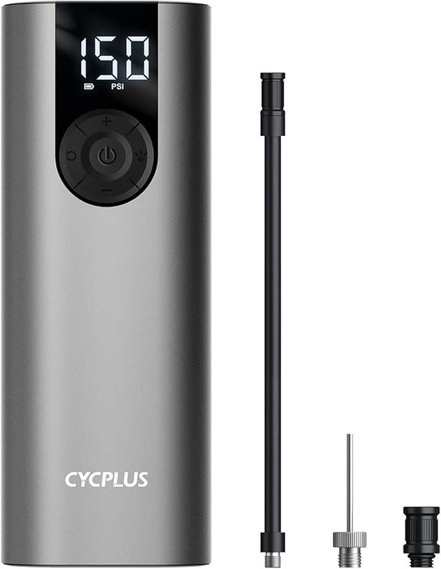

- Posts: 1503
- x 2197
- x 2978
I use one of these portable inflator. It screws on the valve stem. Always carry it, along with a plug kit.
